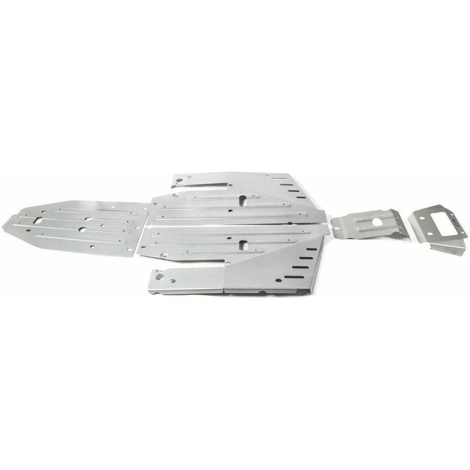

Because of all this I am now determined to either purchase or make some type of skid plate to cover this section of flooring. I already have the metal shields on the firewall for exactly this reason, but unfortunately they did me no good today. With that being said I'm looking for recommendations on a good skid plate set to purchase, as my Google search has revealed very few brands to choose from.

So far after a good chunk of searching, albeit only on my phone with poor service, I've still not seen anything that really jumps out at me for quality vs cost. I definitely want UHMW, not a fan of aluminum for this use.
I did see the SSS one, as well as a Factory UTV one that see OK. Seizmik has one as well, but jeez over 1k$ is getting nuts for about $200 in plastic. Maybe one of the vendors on here can chime in with some recommendations.

You can always cheap out and make your own. A local company here in San Diego has 4x8 sheets of 3/8 UHMW for around 400$.

I actually am considering making my own just for the floor board areas. I made my roof out of 1/4" HDPE and still have a 4'x4' square left ..might be enough to double up some triangles...guess I'll have to make a decision before I run out of luck playing whack a mole with these things.

Any of you fellas on here that don't have one already, message me and I'll get you a good deal on ours. 1/2" UHMW. Protect your manhood.

Yep, the Trails & Rocks models were equipped with a thicker skid plate that covered under the front floor boards. The other XP 1000 and XP Turbo had the "standard" skid plate that left the floor boards open. I actually have the TRE skid plates on our 2014 XP1000, they're a nice part.
If you're looking for inner fender guards, check out the Thunderhawk Performance Inner Fender Guards. They are a full-coverage design that doesn't leave a gap at the bottom (between the inner fender and the aftermarket or TRE skid plates). The picture below is a 900-S, so the skid plate is slightly different, but this still shows how the Thunderhawk Inner Fenders have a lower panel to provide full coverage back to this diagonal frame rail.

Thanks for all the replies everyone. I do have the fender well guards, specifically for this reason. Definitely going to have to get the skid plates though before the next ride. Does anyone know if the super ATV skid plates will work with the fender well guards? I have the ones posted by thunderhawk.
#28 ·
I have the tusk skid plate. It's held up real well for over a year. No drain holes which I liked because I could make my own where I wanted. I also put the superatv inner fender plates on my rig. I know personally too many people that have had limbs thrown through the front wheel wells, one person i know got a limb through his calf muscle. Polaris has no regard to rider safety, lack of skid plate, cages, etc.
