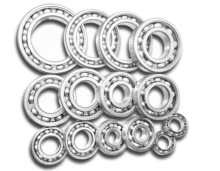

Also since I'll already have the trans out and apart I'm thinking of doing the bearing upgrade.
This is what I'm after there correct?

You should absolutely do the bearing upgrade tho, that is the correct kit,but they do sell one that comes with seals as well.

Ive probably got like 50 hours on my machine, should I get the bearing kit with or without the seals ? I haven't looked at the cost difference to see if its even worth not getting.
Aspiring Perfectionist
5,108 Posts
$130 more for the seals in the kit, I'd say go with what you feel on that one, can probably get by not replacing them, and you can replace all of them without splitting the case in the future as you need to, so it's not something that is urgent probably

I just got both gears for $275 shipped. Now on to the bearings. I was so pumped after I bought the tires yesterday. When I bought them I was like, why didn't I do this earlier? Then I remembered it was because of all the supporting items I wanted to go with them.

I just found the bearings for $200.
What fluid is recommended for the the trans since ill be putting in fresh stuff?
