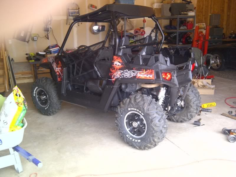

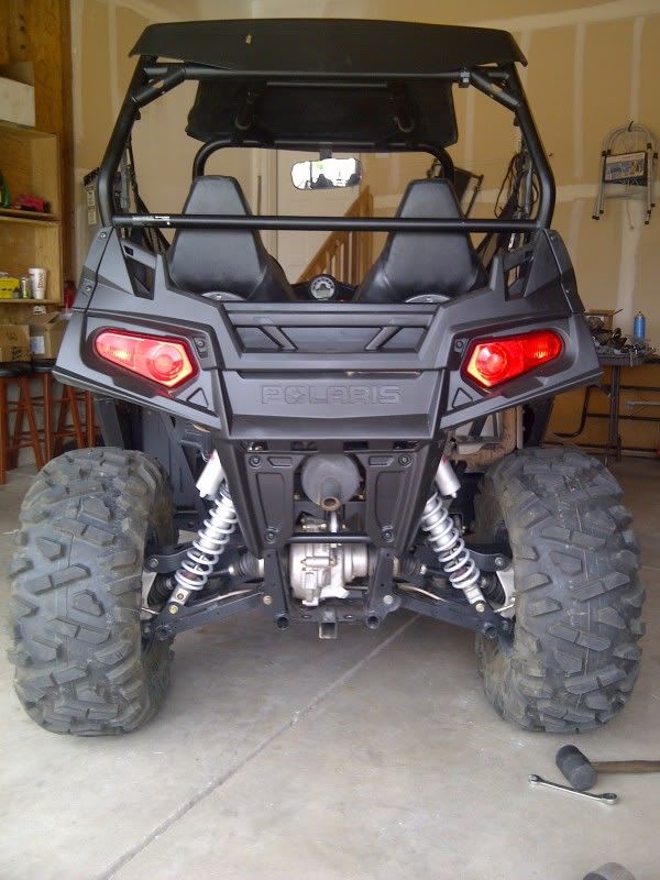

Here are the pics with the DS450 shocks with TRX700XX springs.

Installed the LTR450 front shocks tonight. Pretty easy and straight foward install. I have about 3/4" of preload on them and the front end sits at 12.25" at the low point. With the rear DS450 shocks set with 3/4" of preload the rear low point sits at 11.5". From reading on here, the front should be about 1/2" higher. I may have to lessen the front preload to get this down a tad. From riding it around on the street here, all seems fine. I will use our long Memorial weekend trip to dial the shock settings in. Should be pretty cool. I have the front sway bar off now, but not sure I like the sway as much. Maybe the shocks will settle that down a bit too. After talking with a shock expert, he likes the setup and says it was a good choice. The 700xx springs aren't perfect as preload takes out the dual rate protion of the shock. But should still be better than factory by a hugh margen. I have $280 in these shocks and springs so I'm ahead already. Here are a few pics.

- Both LTR and DS shocks are much better at control than the stock setup. I feel(as set) that the DS450xmx shock is a MUCH better shock than the LTR shocks. I think I will have to loosen the preload on both front and rear to soften the setup a bit for the trails. Both the TRX700 and LTR450 springs feel as stiff as or a bit more stiff than the stock 50" springs. Not a bad thing, but I was looking for a Cadillac ride and didn't get it yet. I think with a little less preload and some more compression tunning and we are there. Lessing the preload will lower the unit though and I don't want that. Maybe a lift, or just ride as best we can because as it sits, this is a jumping/whoopty-do machine. Can't wait to get it to the dunes to see what it can do over the stock setup. On the trails it jumps with control and lands like its on a cushion of air. I think alot of that is leveled on the super rear shock and spring setup. I did remove the front swaybar, and it made a big difference on the rock crawling aspect. I think the rear will stay on as my son drives this unit mostly. Here are a few pics.
