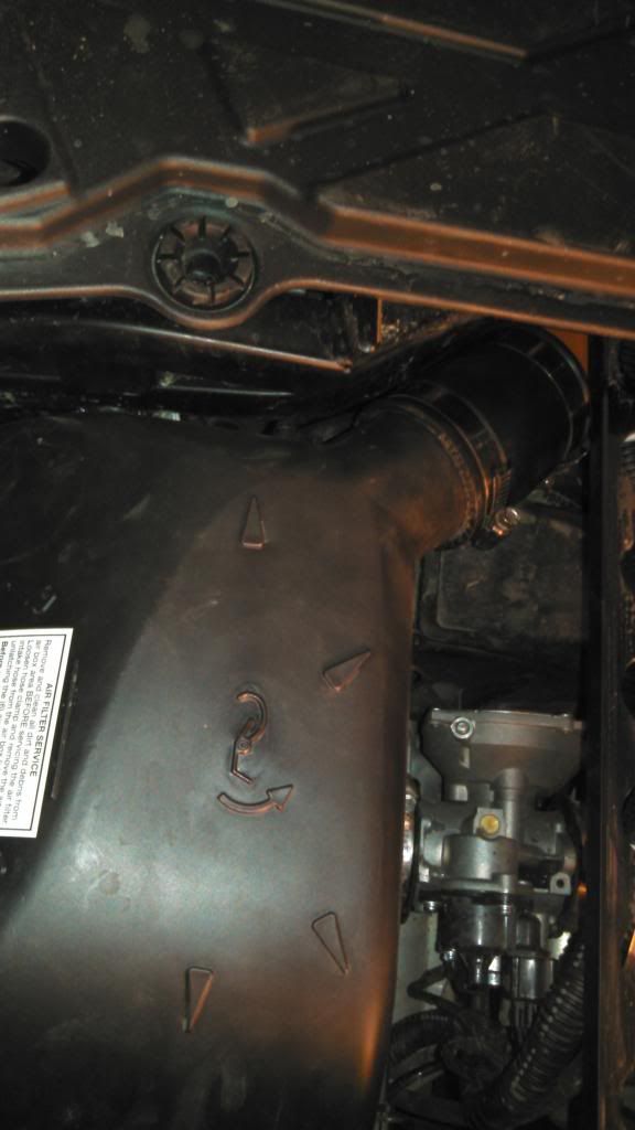

However, I noticed there is another hose coming out of the intake...located on the inside fender area. However, this hose is a one piece rubber setup that appears to run down below the air box housing. What is it for?
Clutch cooling air, vents onto the exhaust pipe to carry excess heat away.

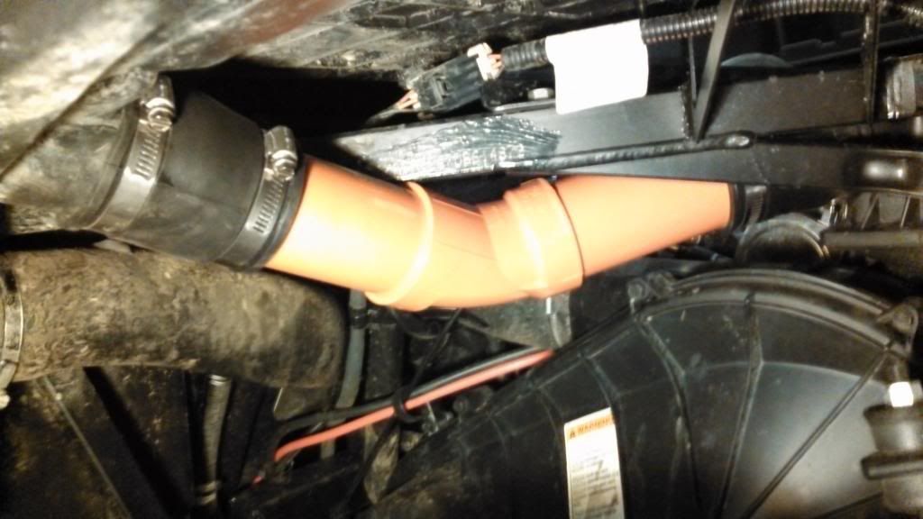

Heads up to anyone with the PVC mod. I'm running 26" bighorns on le wheels.
Seems as though my rear tire touches the pipe and while doing some jumping this weekend
I managed to rip the pipe out. Gonna have to figure something else out.

2" lift would help, probably, along with increasing the shock preload?

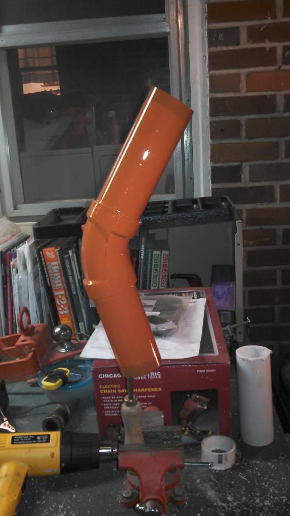

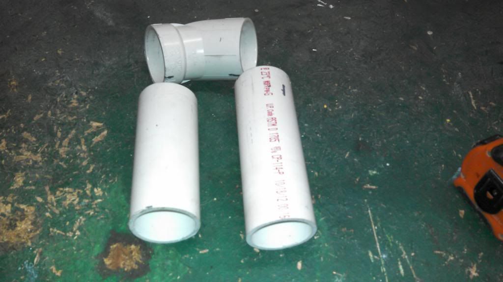

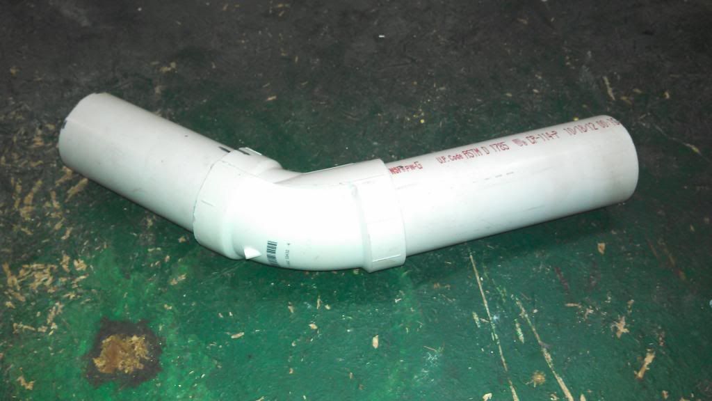

OK I did the PVC Mod and then took it to TWRA trails in Huntsville, TN...Rode the MUDDY MILE trail, (more like 5 miles) not a drop of dirt or water in the box. filter was dusty, but that comes with the weather. guess the pre-filter is next... great Idea for the Mod.
the problem solely starts at the side intake where the o-ring fits onto it. Cheapest route to go is to buy the spectre 2 1/2 to 3 inch adapter from your local advance store.
thats what I did....a few minutes and you're done...Showed the adapter to my dealer and ordered some for his 570s in stock

I did the mod and test rode on Up dusty trails and gravel roads. Box clean!! But had rubbing against the PVC pipe. I had turn up two clicks on the springs all around. Friend advise me to get some High Lifter rear springs. I do have two rubber spring spaces thought about using first. With two adults riding I did this rubbing of the pvc piping. Black paint turn back to white. I have 26 inc Kenda Bear Claws HTR's on original rims 570 LE. Any other suggestions??
Order the soft flex tube that comes on the 2012 model? There are some pix here on the forum showing that one.
