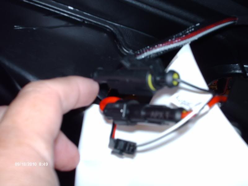

Finally got a few pictures together of the DDM dual beam kit for the 2011 RZR. It has alot of wires to deal with.

Dammit man! WTH? that looks a lil difficult to figure out. Just how hard was it?
$65 for 55w Hi/Low package for a 2011 - that's very tempting!
Does this wire up to the stock hi/low switch or does it have its own?
Wasn't hard just time consuming figuring it out and running all the wires. The kit plugs into one and only one of the factory plugs. The other factory plug is not used and just hangs there. You will also have to run a wire to the battery and a ground. The kit is well made but has alot of wires to deal with. We started to cut the wires to make them shorter but decided against it.

Yes there is an H13 single beam. I installed the H13 dual beam and I still have HI and LO beam and both HI and LO are 55 watt output it just changes the position of the bulb (reflection) as you toggle between Hi and Lo.

I know this isn't directed at me, but I have mine haggardly rigged up to the battery terminals now (quick install before a long night poker run) but hate how the relay and fuse is way back there. I don't know if you have a winch, but when I get back home and re do mine I am going to tie mine into my winch solenoid on the hot and ground wires to: not only shorten up the span of the wiring harness, but to keep two additional wires away from the front drive shaft.
If you don't have a winch, it really wouldn't be a bad idea to run some sort of generic terminal block up to the firewall to tie accessories into. You would only have two heavy gauge wires stretched to your battery and it would really clean up a jumble of wired on heavy electronic installations. Just my ideas though... As long as its lighting off, rig 'em up how ever you like!
