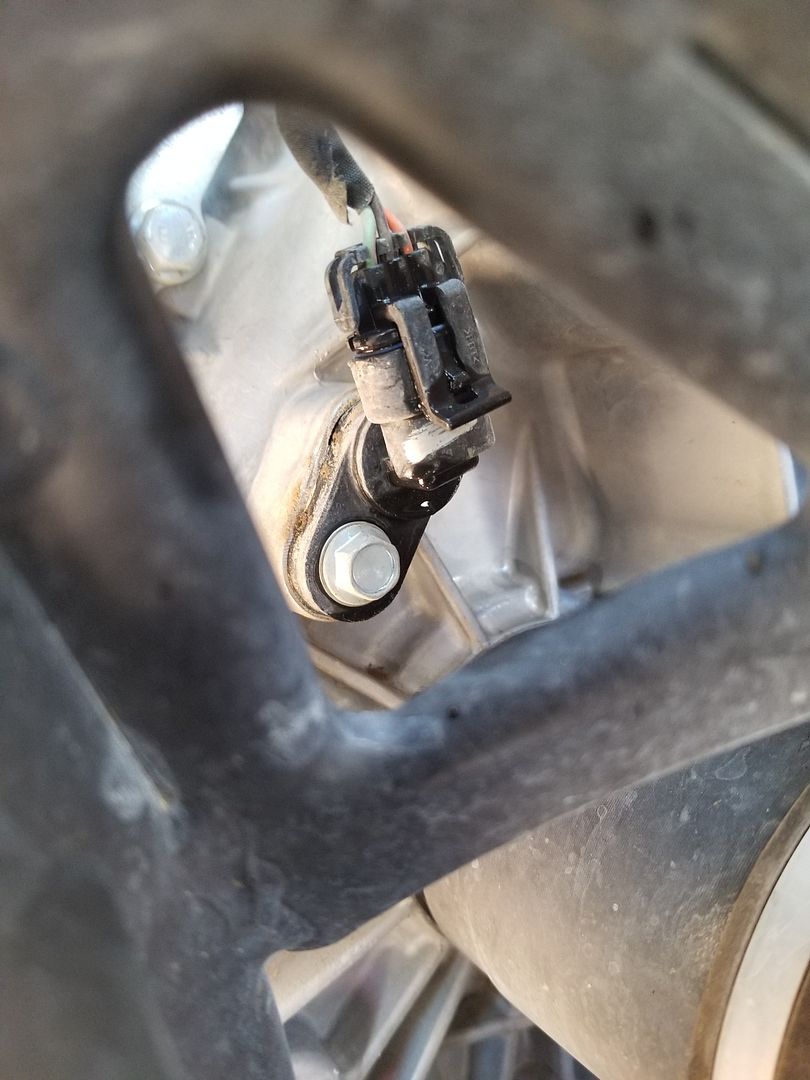

Moved back to rear of machine, cleaned up speed sensor, restarted, and that seemed to be it. Drastic change. Idle was solid, and smooth.

Use your monkey fingers to get to the speed sensor. It's just above/behind PS rear axle.
