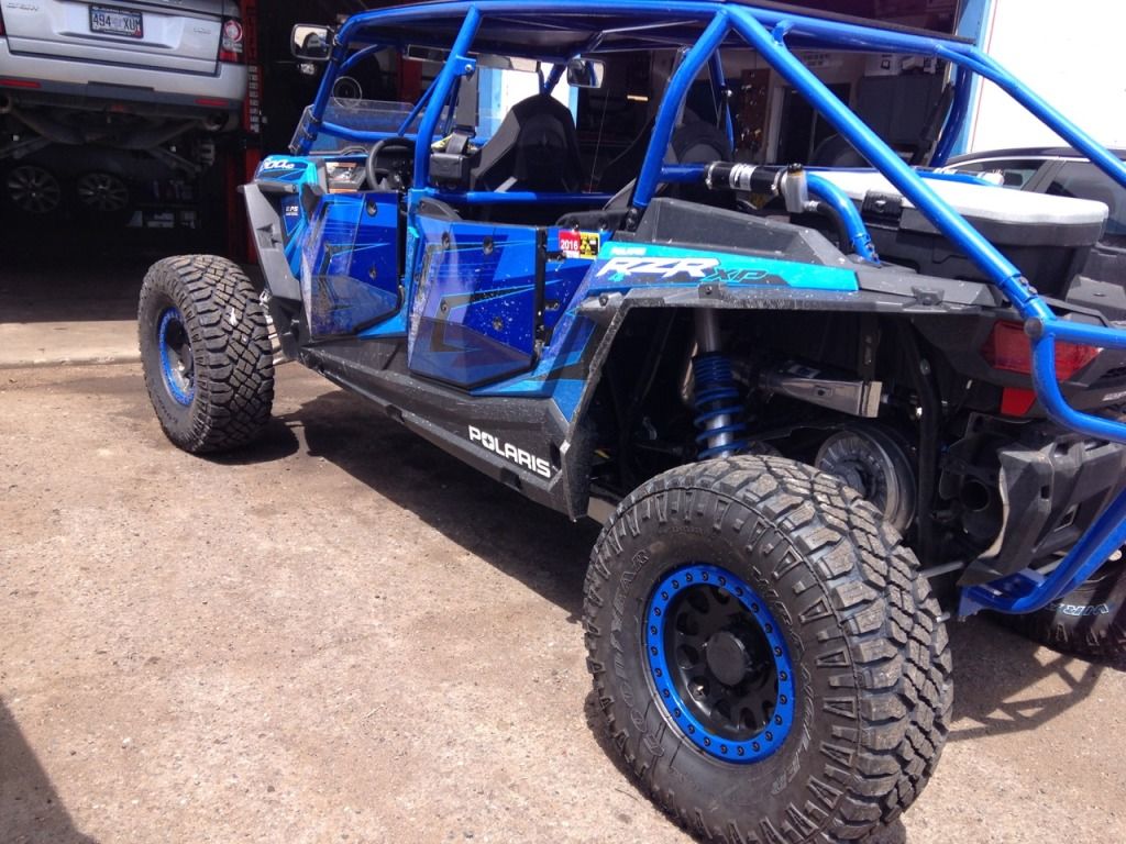

31" 10 paddle. I didn't get my multi position boost switch installed for the weekend so i was running at 10 psi and they did pretty good. I didn't do any racing from a stop to see how well they dig. Hopefully i can get some more miles on the motor and the boost switch hooked up in the next couple weeks. Then more testing.
