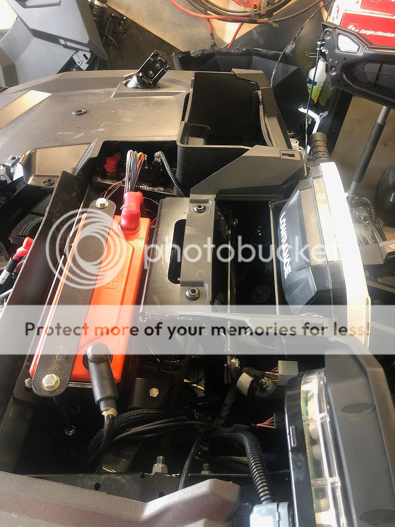

Take a look at this setup for the battery under the glove box

post #7 of 9 Old July 23rd, 2019, 05:19 AM

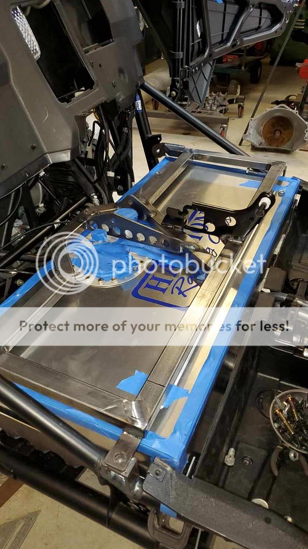

Hereís where I put my battery on the velocity series. To fix my extra fuel.
Wow nice work- what battery is that?

Re: IMS or other Aux Tank on Turbo RZR
Odyssey pc 1100
