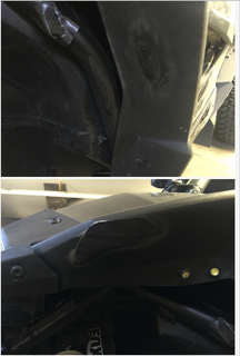

Check out the 32" Maxxis Liberty. They only weigh 35 lbs according to Maxxis so it will help with the not hurting your power and minimizing the need to adjust your clutching. 32s do rub though. ITP just recnetly released the Ultracross R-Spec in a 31/9.5 so that is another option if rubbing bothers you.

Re: 30" or 32"?
Rub marks from 32" Mongrels.
rynomx785 is offline
