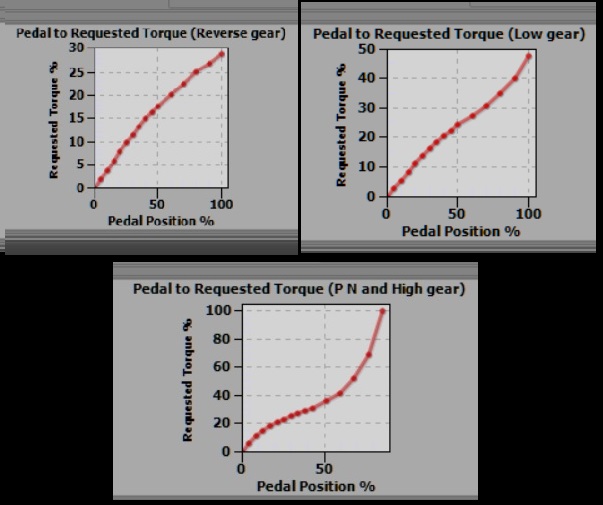

Correction - I had to go look at the maps and refresh my memory. The "pedal to requested torque" is limited by gear selection and not AWD.
Here this makes it simple:
These are the base throttle maps and there are 2 more for each gear with other factors. These can be easily tailored to what you want with a PCVX

If you get a tune from a "tuner" it will be locked and you will not be able to see or change anything. However, with the PVCX you can modify the stock tune yourself. Hell, if you get one I'll modify the settings to how you like for you.
