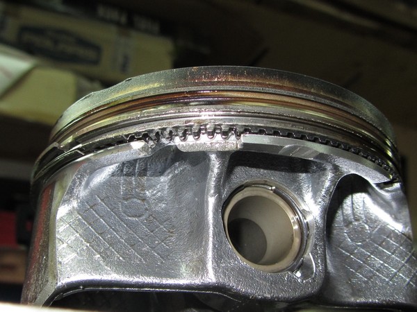

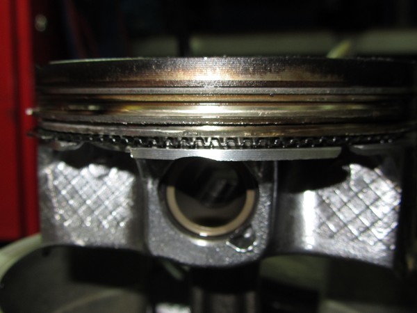

Hi all! My name is Sergey and I am from Russia. I have a similar problem with the motor. after 100 miles the motor jammed. after opening of the motor saw that shot off the bottom of piston and the lower oil ring. when the motor is jammed in the motor oil was not. never leaked oil!

Yes..looks like you had the same problem as a lot of us..lower piston land gave way...then you consumed oil at a high rate, till the motor gave up.
I was using over 1qt every 50 miles..
