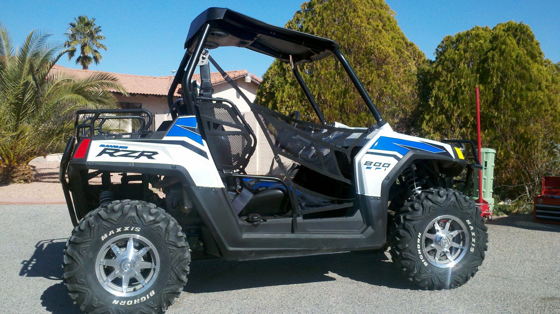

This one has 26 x 9x 12 on front rims with a 1" spacer on all 4.

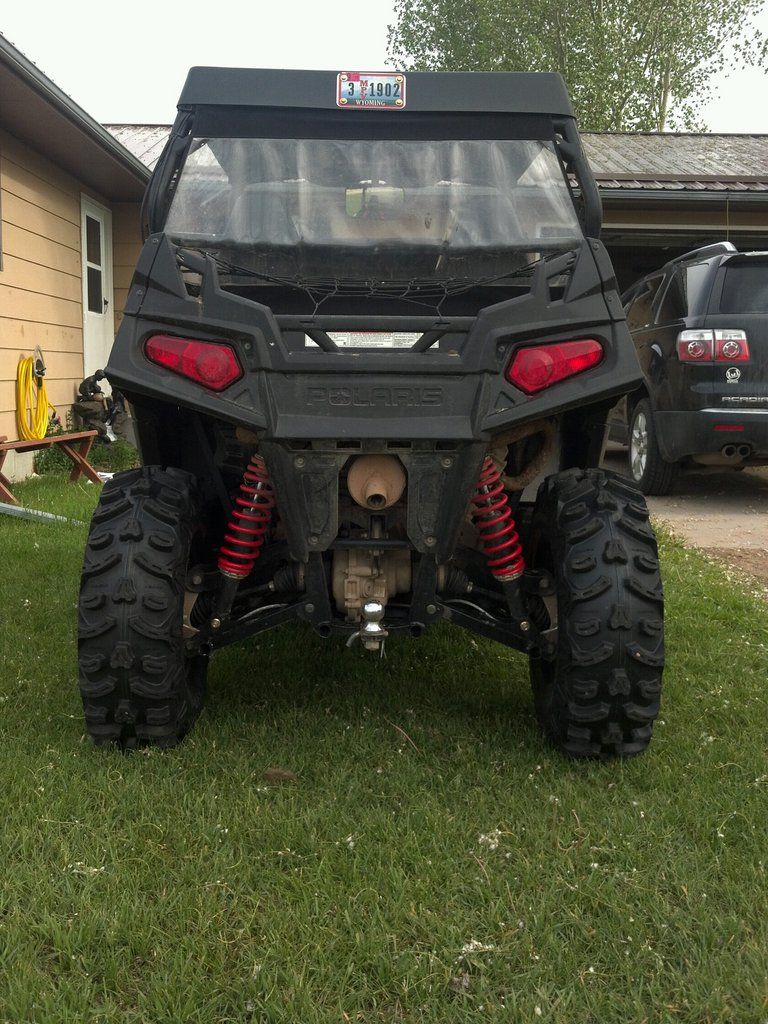

[IMG][/IMG]
Here is 27x9s on the rear with front wheels
[IMG][/IMG]
Measure right at 49.5" wide. This is with the Racertech 2"lift which pulled me in about 1/2" So with no lift youd still be right at 50"
