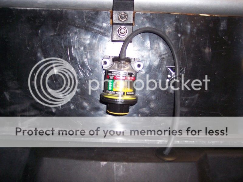

The Vent Racing system, using a Donaldson filter system, also mounts to the frame. But, the intake boot I have has a bellows in it that allows it to flex. While installing it, with the bed off, I put the boot over the canister outlet and shoved it as far as I could towards the throttle body. I replaced the clamps on both ends of the boot. I made sure the boot was on to the throttle body as far as possible then clamped it tight. Then did the same at the canister end. The Vent Racing system comes with a clamp around the canister body, so the canister can be moved to the right.
Here are some pics of my Vent Racing install:
Here is info on the heat shield I used on the canister. Attached it using good 'ol 100mph aluminum tape.
As you can see there is a brass threaded insert in the Canister neck. I used a brass Tee and attached the valve cover breather hose and a filter minder to let me know when the filter is becoming restricted. Just like my diesel pickup very handy. As you can see I mounted it between the seats so I can see it in my rear view mirror.
Lemme know if you have questions.
Pirate
