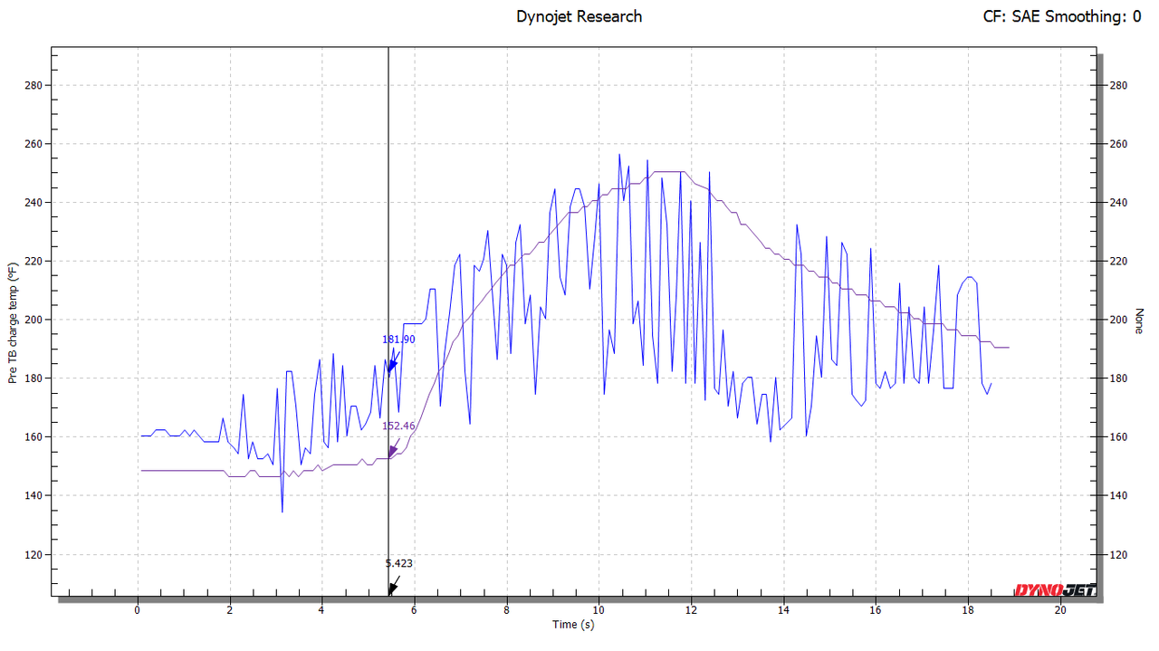

After looking at the data logs, I've concluded the computer is seeing and issue with the pre TB charge temp data....but only when the issues starts to happen. the baseline log looks normal, and the log with the problem is all over the place. This is the only input sensor i can see that looks out of place... the ECM output for fuel trim, boost, timing, etc is also way out of line, but thats the effect of the data the ECM is seeing from the pre TB charge temp i think. Post TB charge temp is normal on both baseline and problem logs.
Here is the Pre TB graph, smoother purple line is the base log, crazy blue is the problem log:
Very well could be the sensor going bad, or a noise/ ground issue... I'm looking into the problem now, just wanted to put this out here preemptively in case anyone has had the problem or has had any input.
The oddball with it being the sensor or ground is that it only does it after riding for so long, so i'm leaning toward a long term heat exposure issue.
Also, just to add, it's not directly related to engine temp, during the 30-45 min of good running time, I had the engine temp up to 220 and it never missed a beat.
Thanks in advance, and any input is appreciated, I'm off to chase the issue and I'll check back periodically during the day.

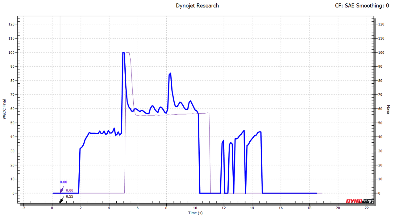

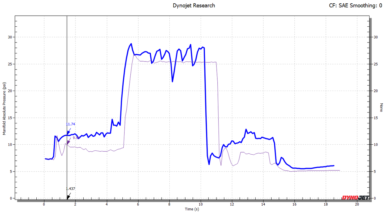

After further looking into the service manual and grasping some functionality... it appears the issue could also be from the Boost sensor, Turbo, or Wastegate..... I didn't realize that the pre tb charge temp sensor, is also the boost sensor, the boost graph is also crazy.... as is the wastegate
Boost Graph:
Wastegate:
MAP:
