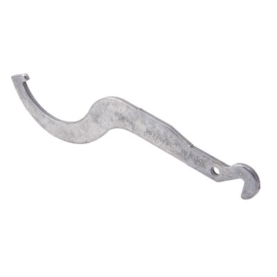

Screwdrivers make it super hard to change,
Get the right tool, there should be one included with your polaris oem toolkit under the hood, my 2012 900 xp had one from the factory.. it is the belt removal tool on one side and the shock spring adjuster on the other side
https://www.rockymountainatvmc.com/p...ol-p?s=1542870
Under $7 bucks

I got that tool and Iím using it as demonstrated in the videos. The belt is still way to tight around the secondary to roll it on.
And there's still the problem with the howling. Iím trying to put on a Gates GForce belt now to check if the belts the problem of not. When my Hunterworks gets here Iíll swap them out again. Mmmmmm, looking forward to that!
