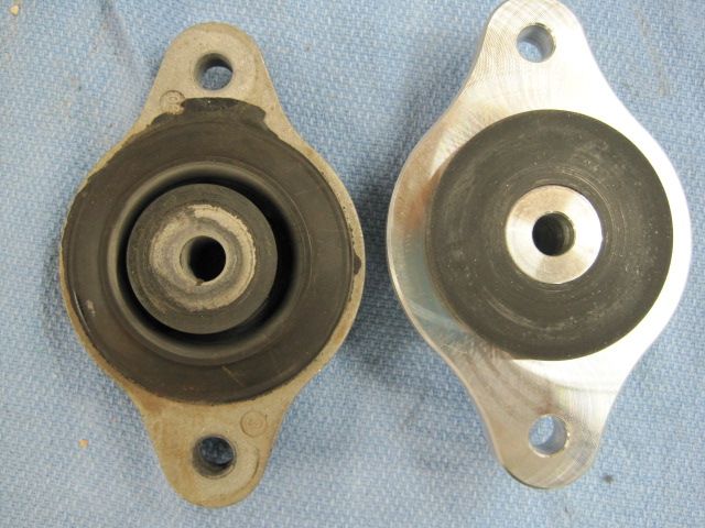

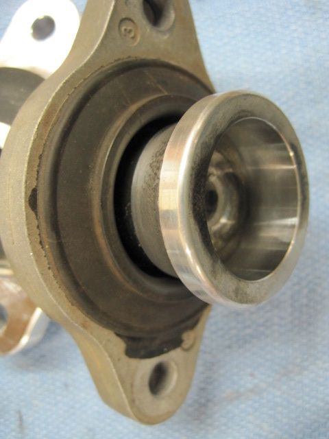

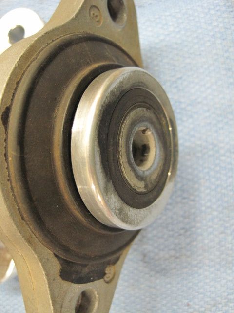

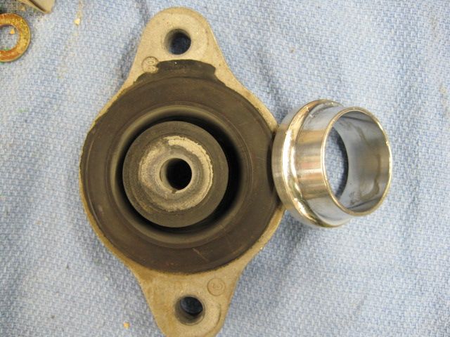

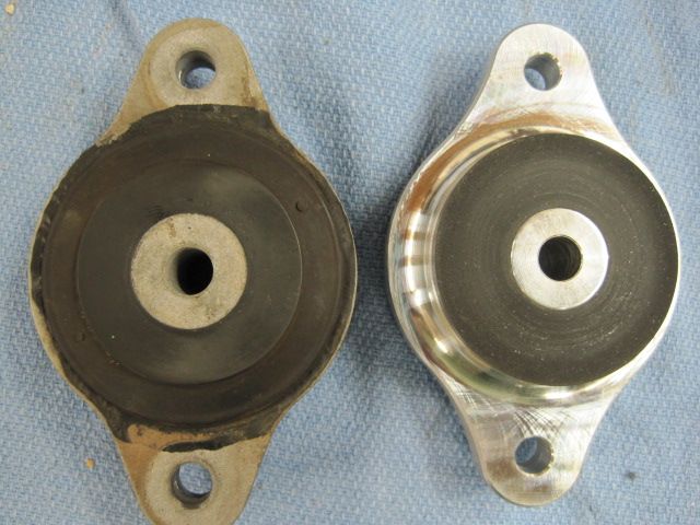

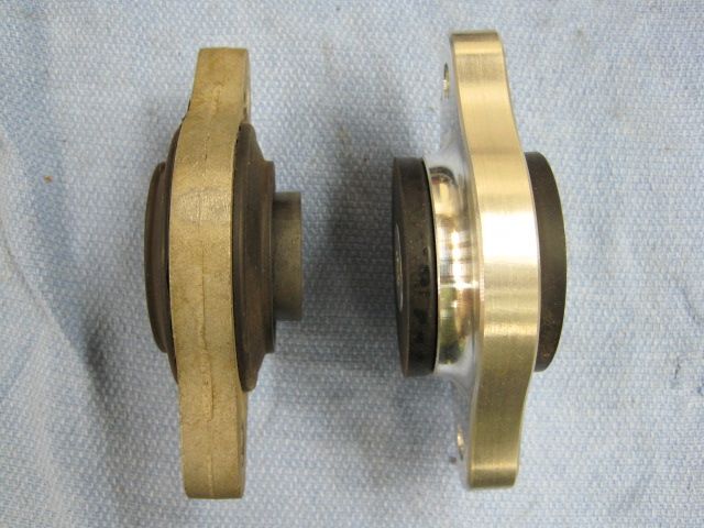

Here are some pics I took when I removed me HPD inserts and went to the Holz mounts........I ride sand mostly and I can't say I noticed any extra vibration for the engine after the swap out. Holz is a one piece mount

Excellent comparison photo's Gary...
