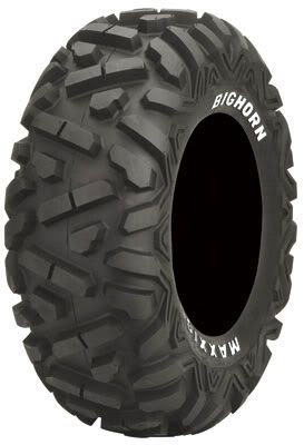

This thread looks at the difference between the Original Maxxis Bighorns & the Bighorn 2.0's. Also If you own either of these tires a reply with your review would help future owners in making the right decisions.
Maxxis Bighorn Radial ATV/UTV Tires
The tread pattern and wide footprint give this radial exceptional traction, and the Bighorn’s shoulder lugs protect the sidewalls. Solid raised white lettering gives this tire an attractive look. With radial construction, recreational riders as well as ATV racers have appreciated the ride quality and comfort.
► Radial construction.
► 6 Ply
► Extra wrap around tread for rocky conditions.
► Raised white letters on one side of tires.
Bighorn ATV/UTV Tire Specs**
Tire Size____________Tread Depth32nds (Inches)_____________________Weight- Lbs.
25x8-12__________________28/32 (.87")_________________________23.6**
25x10-12_________________28/32 (.87")_________________________27.8**
26x9-12__________________25/32 (.78")_________________________25.2**
26x12-12_________________25/32 (.78")_________________________29.9
27x9-12__________________25/32 (.78")_________________________32.6
27x12-12_________________25/32 (.78")_________________________36.8
26x9-14__________________25/32 (.78")_________________________23.0**
26x11-14_________________25/32 (.78")_________________________27.8**
26x8-15__________________25/32 (.78")_________________________19.4
26x10-15_________________25/32 (.78")_________________________25.6
** Tire sizes colored in Green are available in BOTH the Bighorn 2.0 as well as the Original Bighorn.
