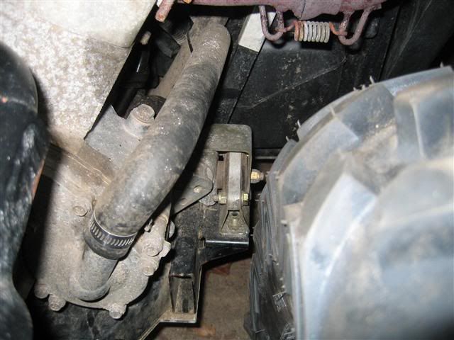

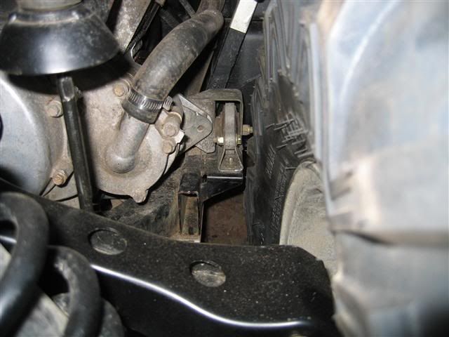

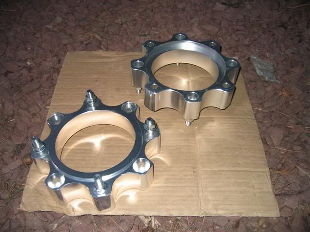

I just mounted BH 2's on my stock aluminum rims yesterday. I went with 26x9x12's in the front and 26x11x12's in the rear. You definitely need spacers in the rear. I went with 1.5 inch spacers in the rear only, no spacers on the front. The rear cleared the motor mount but it was close. The fronts fit fine. I haven't try them out yet because my damn battery was dead!

I went with 26.5 Pitbulls. Three things had to be addressed on my 2011 50 incher. The passenger side rear motor mount. The driver's side front wheel well rubbing. The top of the rear tires hitting the bottom of the wheel well(where the fender flare is). There's a number of ways to address these issues. I went with 1.5 inch wheel spacers and a 2 inch Racer Tech lift.
