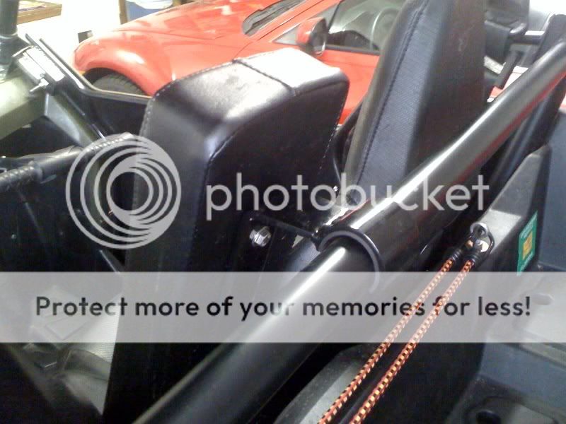

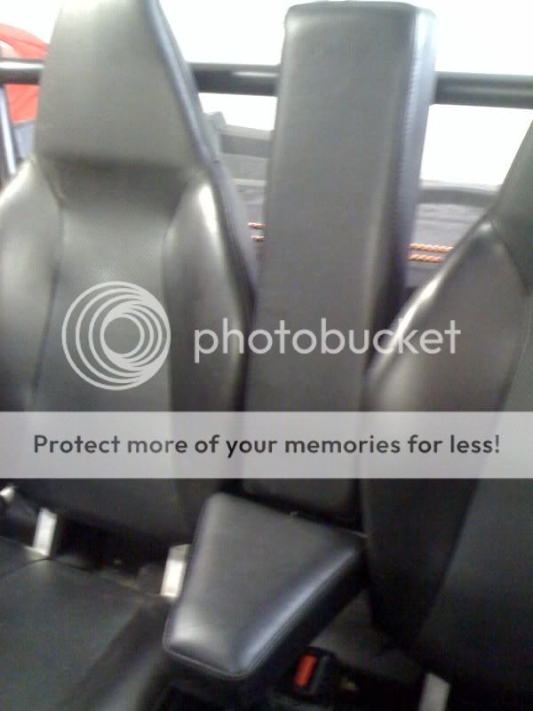

I would have to agree that an aftermarket bench seat would provide better overall support, however with a 4 point harness to accompany this homemade job, its very safe. This seat is a quality well thought out and engineered product. Hooks in the bottom plate and around the rear roll bar cage. It stays completely stationary. It weighs 25 pounds, and is powdercoated. Unfortunately my friend is not making more. Heres a few pics to give a an idea if you want to build your own.

I am thinking bout the same thing. That looks really good!! My idea was to use angle to make a bracket to bolt to the plate between the seats, 3/4 in plywood with thick dense foam and wrap it with vinyl. I want to cut the out of the center of the seats to make it look like a nicer fit instead of a straight backrest. Then use a regular car lapbelt and bolt to the existing mounting plates. It's hard to visualize. When I make it I will post pics. Trial and error!!!

Sounds like a plan. If you do alot of wet water riding or plan on getting that seat wet often, might I suggest marine board instead of plywood. Will hold up to moisture better over time. Good luck.
