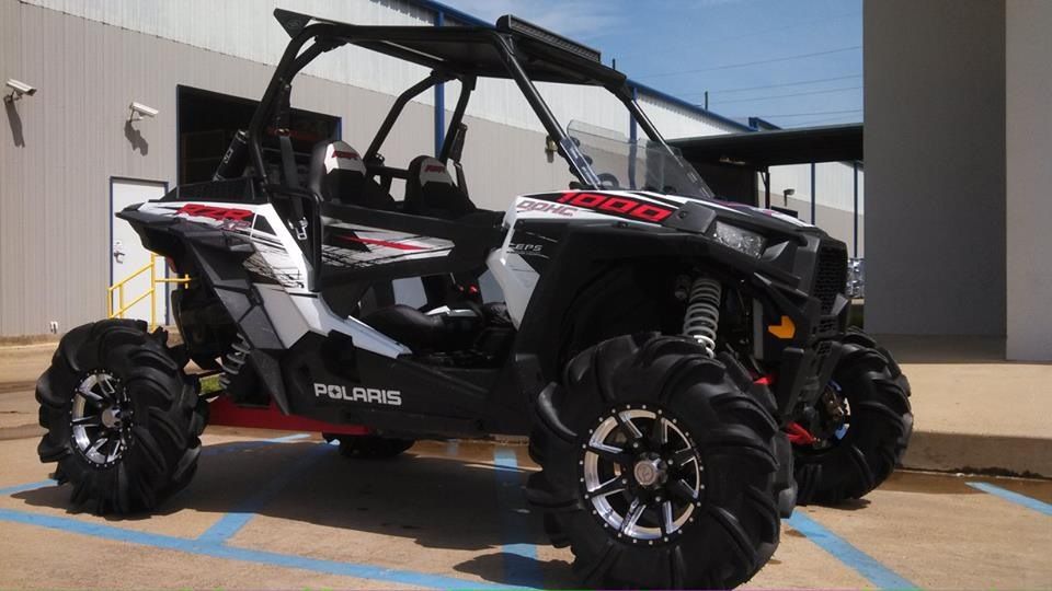

I just got these today for my 1000 they are MSA 20's with 16" rims with 30" tires

Quote: Originally Posted by Swimnow View Post
Here is a picture with them on
29.5s? I wish they made the 2s in a 31 or 32. I want um a lil bigger than stock. Want the wheels like this one though
Looks good are the a true 30" tire? I was pretty disappointed w the stock
29" bighorns not much taller than 26" stock bighorns and no where near the OL2 29.5's I had on my old RZR.
