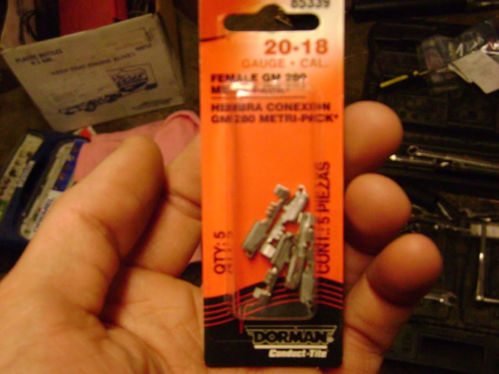

There are a couple dead holes in the factory fuse block. I found terminals that can be made to work at pep boys and added another fuse to run my oil pressure light I added.
I got power from another wire in the fuse box, just added a new terminal to the end and put a jumper wire to the other "dead hole"....as seen on the right of the fuse box here.
Doorman part number for those who must know!
