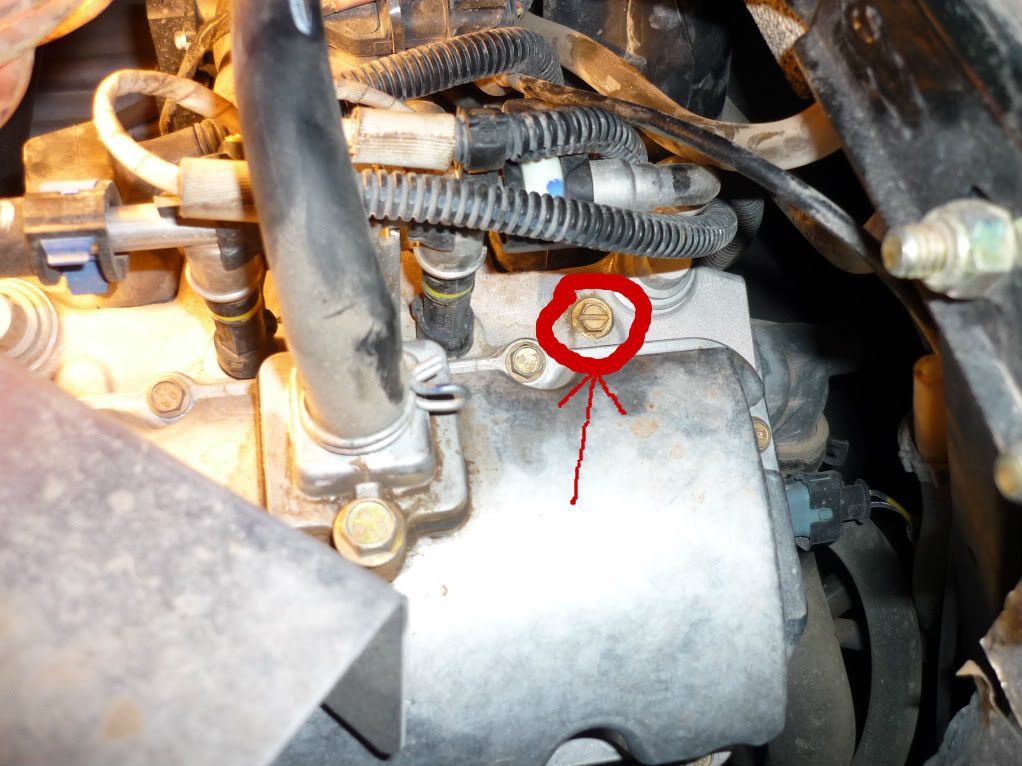

Can anyone tell me where the bleed screw is located for the coolant on the 2011 rzr s? i installed a new cbr radiator a while back and im not sure i have all the air out. I winched the front end up in the air and filled while squeezing the lines. Im still running around 204 degrees with new rad, hoped it would run a little cooler. thinking i still have air in system maybe.

on older s its on thermostat housing.

It's on top of the head,clutch side.don't have a clue why they moved it.I removed the bed to get at mine.

Hope this helps

Thanks, I searched and searched. Appreciate it.

It's best to elevate the front of the rzr its helps a lot and repeat the bleeding process several times.

why did the image get erased? such crap

I still see it,but here it is again

ya ya ya, i got it. mucho gracias!!!! thats awesome. i was searching everywhere on the coolant system and thermostat. prolly would haave never found it. very helpful.

Thanks for that pic post. I have been looking every where for that damn thing.

I can see why you had to remove the bed.
