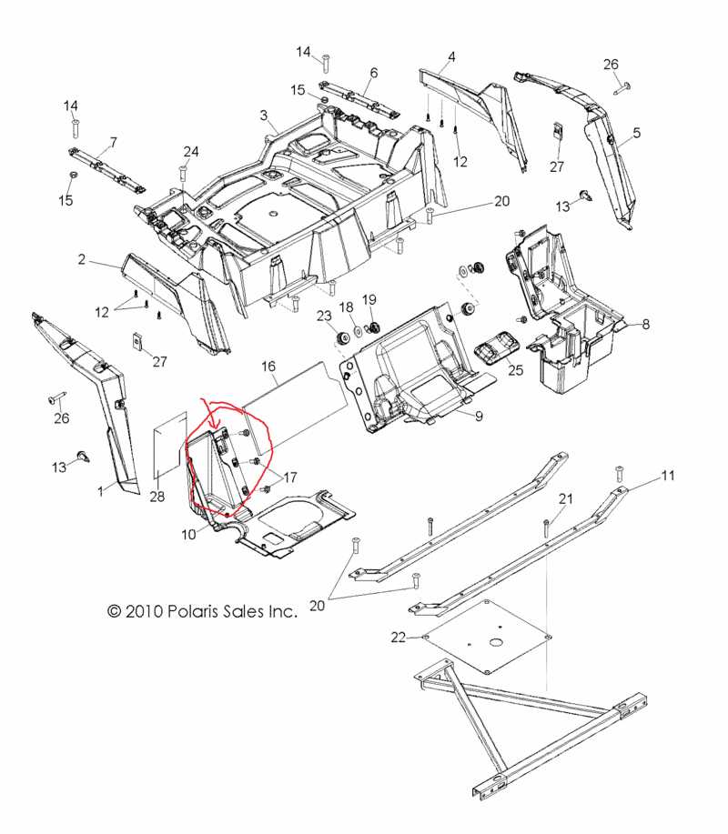

I read a few posts of guys having the plastic melt where the top right hand motor cover latch area is. I had mine off today and mine had a melted hole 2''x2'' above the latch. Mine only has 50 miles so if you have a 2011 best go check yours! I made a small heat shield out of aluminum and slid it in between the frame and the plastic back plate that the motor cover locks to. I think this will take care of the problem.

pictures please. thanks

This must be an S issue because my '11 RZR4 has no melted areas. Could you guys post some pictures so I know exactly where your talking about. Thanks

its simple to find, take out the passenger seat and look around the turn lock that holds the motor cover on. You will notice it for sure if you have a problem. here is where it is, circled in red.
Mine was melted pretty bad too. I put on a ThunderHawk thermal shield today (4m supporter), which is basically just a piece of aluminum with some holes drilled in it. Nothing too fancy, except its cut to the right size. I think it cost about 31 bucks with discount.
I am sure dealers will replace this under warranty, and maybe they would even put on some extra shielding?

Quote: Originally Posted by HIGHOCTANE View Post
does the 11 have the aluminum tape in that spot like the earlier models have?.
It does but it stops short a few inches from where they are melting.
