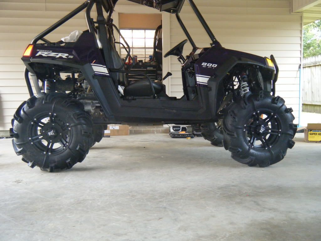

i think at 3" you will get binding on your cv joints at full droop,when you jump or the wheels come off the ground ,i have the 2" racer tech on mine no issues
Name:	2 rzrs at office.JPG
FJK is online now   Reply With Quote
