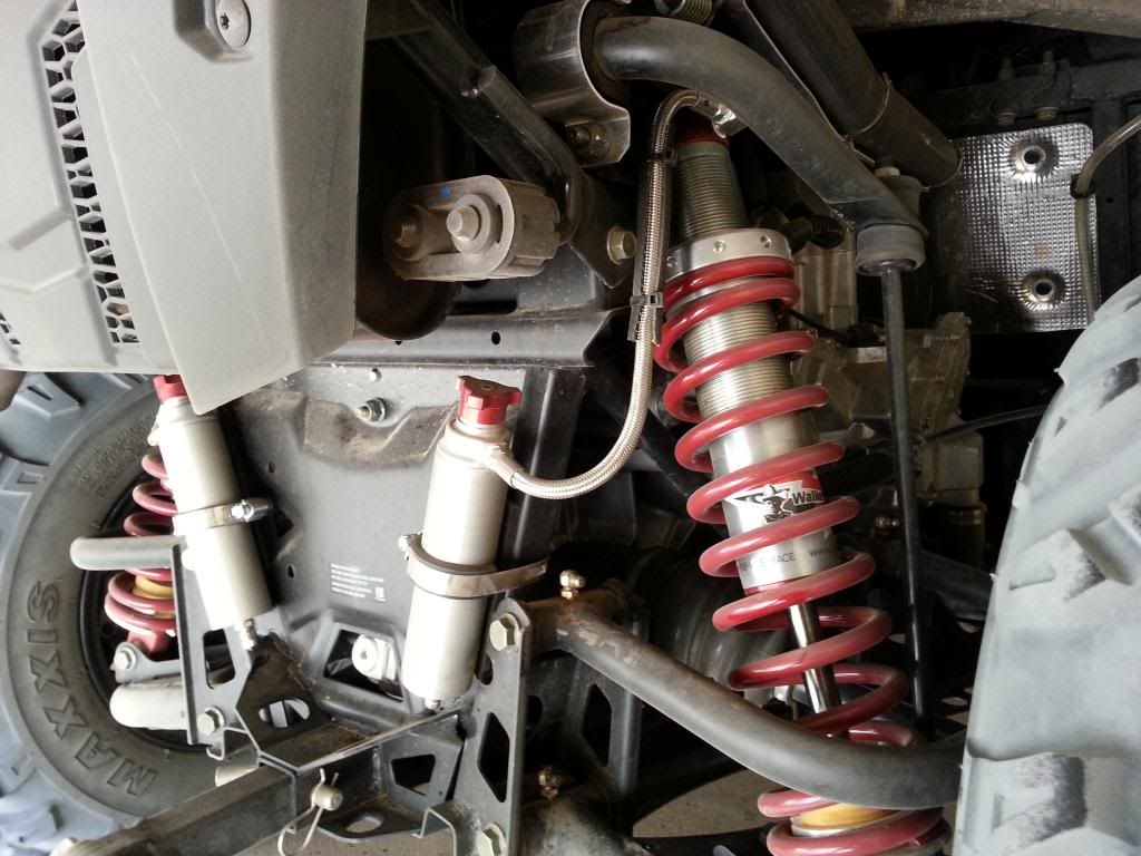

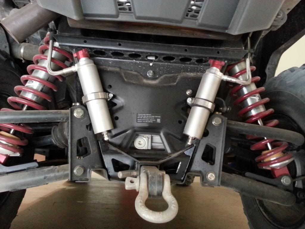

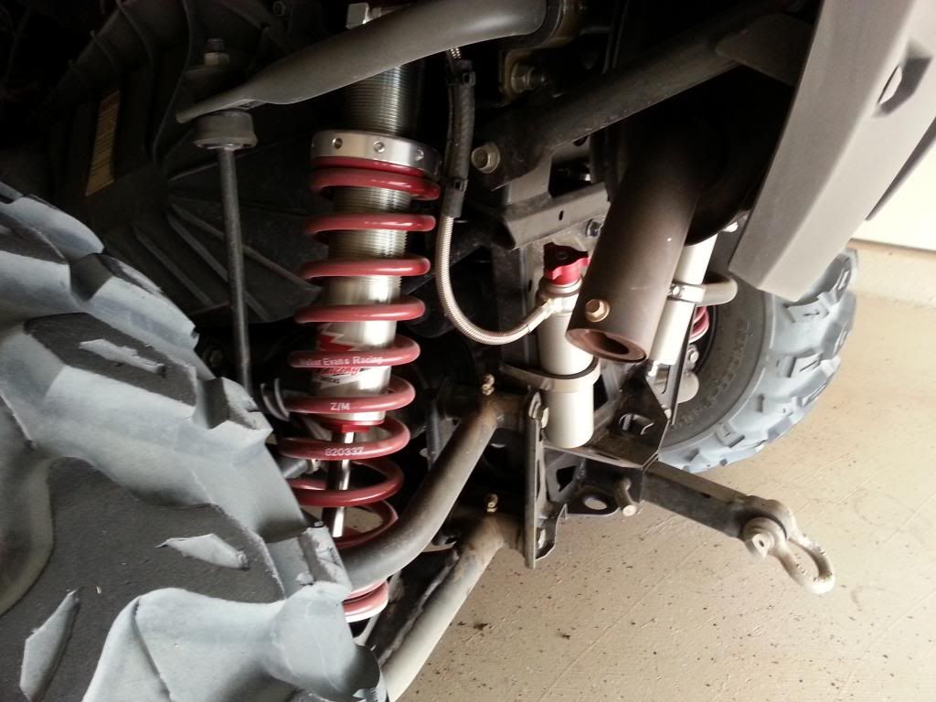

Well I have them installed and I'm really happy with how they improve the ride. AuMiner tlod me where he mounted his rear reservoirs (the correct way). But being the impatient person that I am I already had them mounted and was out riding.
There is a hard rubber spacer between the reservoir and the frame along with the strip under the band securing them. I like the location because its away from anything thrown up by the rear tires.

Old June 16th, 2013, 09:45 AM   #7
DHive's Avatar
First Name: Dave
My RZR: 2012 RZR 570
Member #44585
Join Date: Sep 2012
Location: Ohio
Posts: 574
View DHive's Photo Gallery(0)
Re: Walker Evans Shocks
Do you have a picture of where AuMiner installed his?

DHive, send me your email address and I'll send you a couple pics. Feel free to post pics to this thread if you wish. I have trouble posting from my phone

Be careful not to back into anything that might damage the hose; thick sagebrush comes to mind... Almost holed my radiator making an unplanned U-turn!
On second thought those look like the steel braid-covered lines; those are real hard to hurt!
Action, nice work on the scuff guards too!
