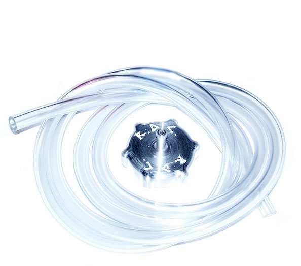

Quote: Originally Posted by markcrain View Post
First off GREAT post. I found 5 vent hoses in frame near air box. I assume they are rear diff, trans, transfer case, fuel tank and got no clue. I found the front diff and the main reason for my post is the radiator vent. I opened lid and see some dirt in it so it does need vented. I don't see enough room for a brass fitting to hook hose to. I am pretty sure it will hit the hood. Did you go through the hood? I was thinking I might use a piece of Gortex under cap to catch water but allow it to breath. Any thoughts on that? Any idea what the other breather is?
I'm using one of these for our rad overflow bottle, we make them, it fits fine....
