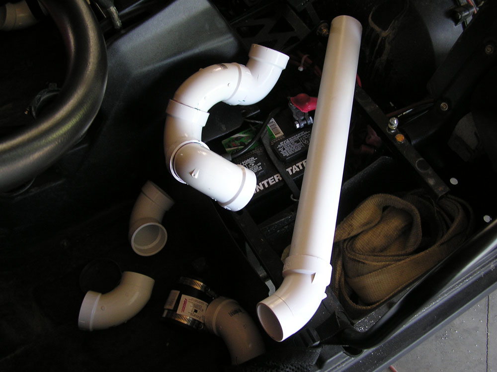

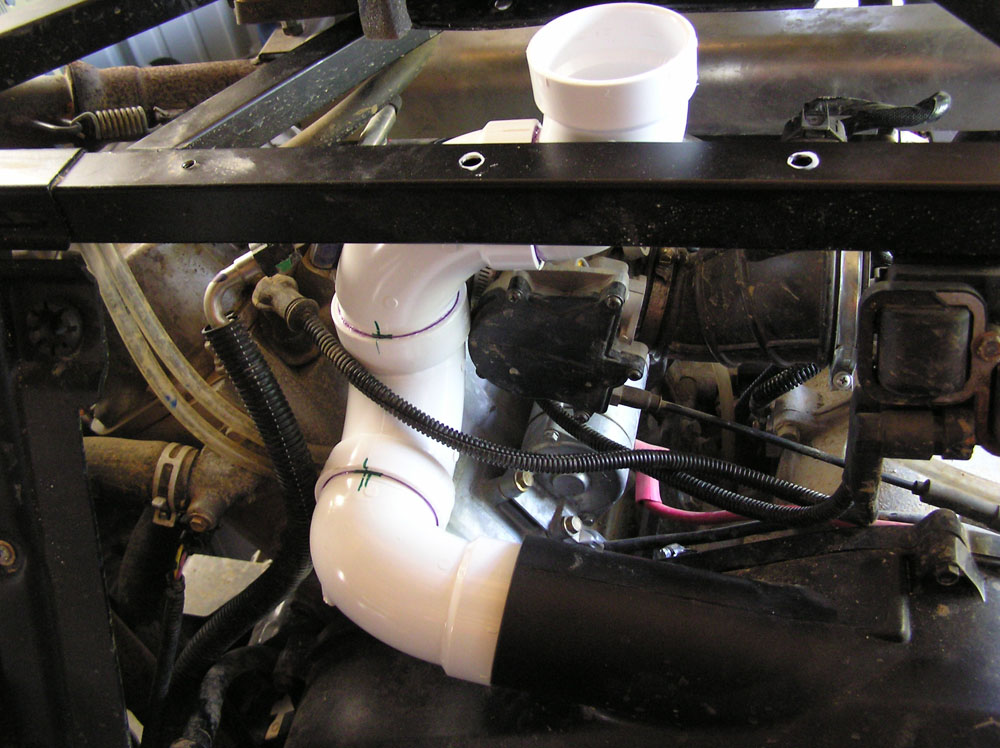

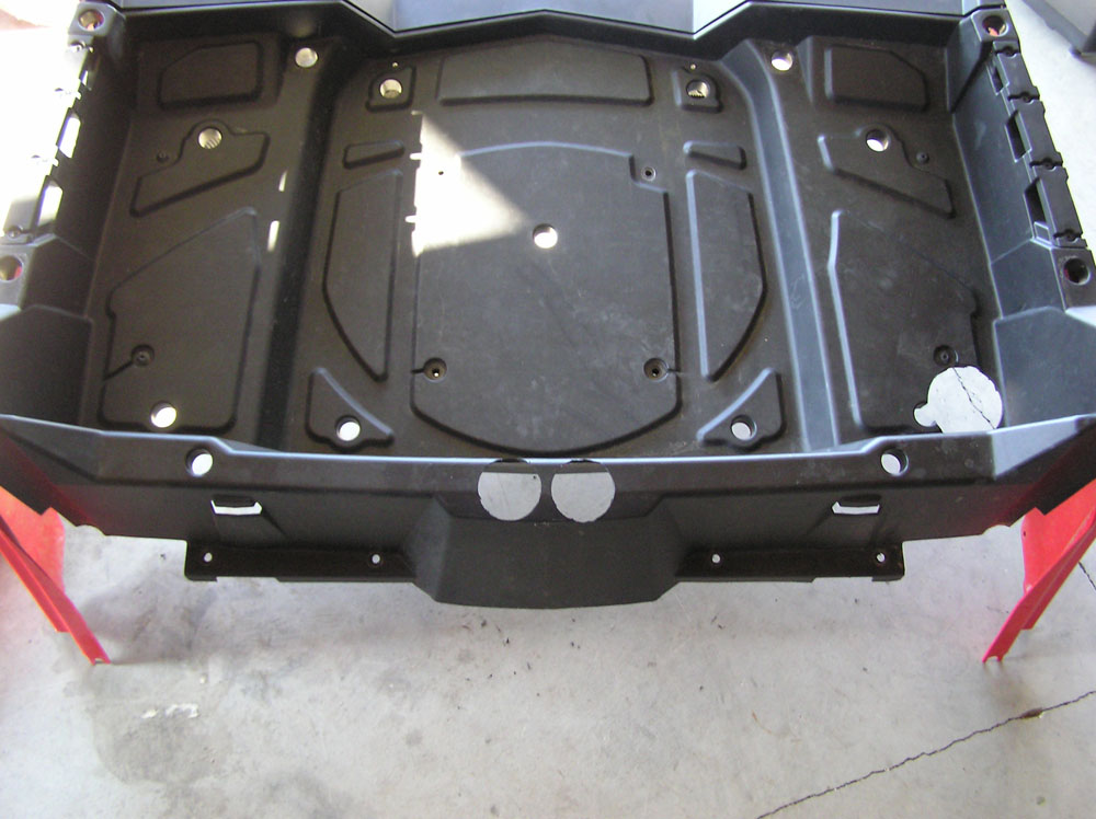

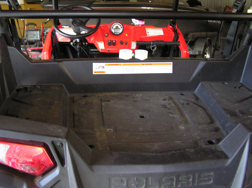

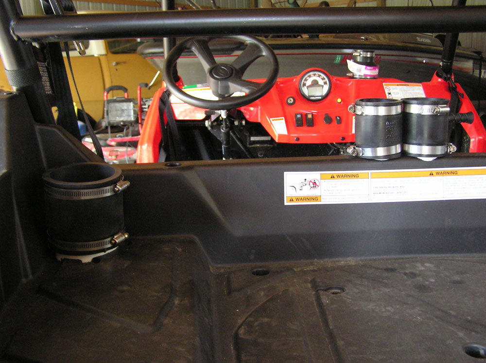

Well, I started my snorkle today and only need a couple pieces to pic up tomorrow to finish it up. Here's pics of the progress! Let me know what you think.

why did you reinstall the airbox now that your not using it anymore ? and with your filter up above the bed arent you concerned with tree's and brush hitting it or do you not do much woods riding ? not knocking you as youve done some fine work just wondering

I do tons of thick woods riding, but the filter is below the bed, so the stuff won't get to it and it's pretty tough. The black K&N can under the bed is my new filter setup. The stack above the bed is just the snorkle and it will be below the roof, so nothing can get to it. I reinstalled the factory snorkle box to keep the snorkles lined up when taking the bed on and off, plus it helps keep the dust from coming into the cab through the opening where the stock breather use to be. Let me know if you have anymore questions. I like to help people out as much as I can. I'll post pics of my lift install later this week and the finished snorkle probably tomorrow.

Man I didn't even see the K&N under the bed, I thought you were going to mount it above the bed. Now I see it.. Looks good, can't wait to hear how it works!

Pretty much how I did mine. It is hard to make the pipes come up straight, so you have to use the black rubber connectors like he did. I have all 3 of mine coming throught the bed. Nice job.

LOL, I forget sometimes when I start getting into it. Time goes by quick and next thing you know....your done and no pics. I finished the stacks yesterday and undercoated them, then painted them today. Hopefully they'll be good and dry tomorrow, but it's pretty humid out. I'll have the finished pics friday after I do the clutch kit that comes in tomorrow. I'll probably take pics of that too. I made my air intake snorkle have the ability of ram air if I choose, or I can rotate it to take air from behind and be fully protected.
