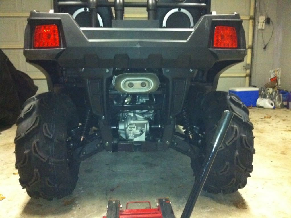

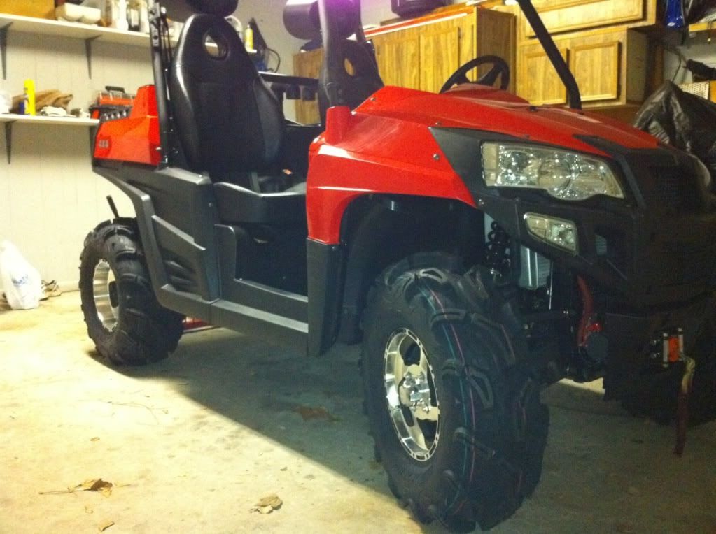

This is mine. It's shortfall is the suspension....moreso the short a-arms. A long travel on this is what it needs to run.
Hilliard front locker.
Bomby 800 copy engine. As was mentioned earlier, the 912 kit fits. The guy has it running and fast. He is in Canada so it's kinda off season.
Bomby 800 clutching/springs and belt.
Mine is snorkeled with 28" zilla 10's&12's.

I have talked with my distributor about the suspension. They are going to contact the manufacturer about making a racing suspension kit for these. shocks a arms axles etc. Hisun has a nice wheeltrack kit for it. A company in europe a hisun importer called emu has a cool video on youtube bout 10 min long with a sport version they did with baja rack and long a arms.

Yup, saw that. They have a track system also. You just can't find any info other than the video.
This machine lacks suspension...that's about it. I've removed my sway bars and it feels nicer but it's tippy. I'm considering putting the rear back on but we really don't ride fast trails. I know a guy with walker evans Rhino shocks and he says they are worlds better. The place I got it from also sells a different set of springs that are supposed to help.
I think it just needs more travel and better shocks. Maybe some piggyback type shocks would be a good start. Could even have them revalved for the weight. I dunno.
Right now, I'm working on richening it up a bit. In normal trail riding the headpipes glow red. Not blasting down trails but simple tooling around. That's lean....real lean. I have a pair of xied's coming for my harley. They are simply plug and play resistors to fool the ecu to increasing the afr to 14. This might very well wake this thing up. It runs well now but is certainly too lean.
I'll experiment and see how she does.
