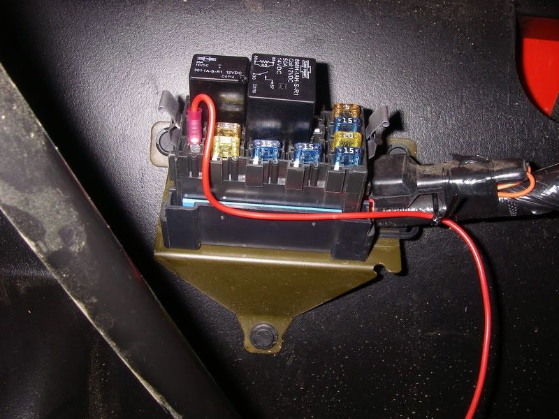

There is an empty accessory spot in the fuse box in the lower left corner. It's for "always on" connection to the battery. Just push a 1/4" terminal into the opening. No need to remove the box. A small wire will fit under the fusebox cover but a larger wire might need a small clearance notch to be filed in the edge.
I wanted my winch to work with the key off so this is where I attached the rocker switch wire.

Yes....very easy to do.....in each corner there is a small tab that must be released and the fuse block comes out. I used a 90 degree pick to lif tabs. Once done you simply just push block back in till you hear the clicks...TA DA
