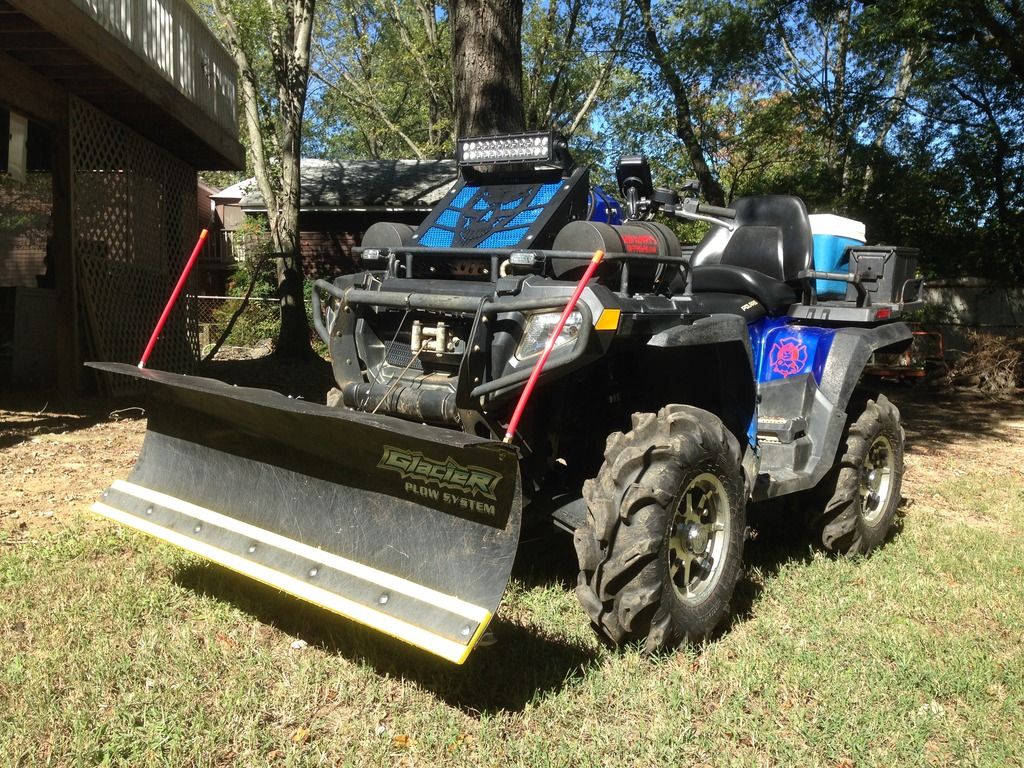

I put one of these on my Sportsman's plow, and put the stock metal bar on top of it for strength. Haven't used it yet, but this setup was highly recommended by people that use their plows a lot

I'll have to measure it, but it's in the 5"-6" range. Just like the one Tiorum3 posted, this one can be flipped when one side wears. I've been told the poly wear bars are almost a must when plowing concrete so it doesn't scar up the concrete. My driveway is concrete, so I figured I'd give it a try.
