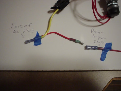

Trying to install my PIAA Lights, but I only want them on when the key is on. I'm already using the orange accessory wire they give you, because my winch is already plugged into it. Is there another wire that I can splice into that will only work when the key is on. Thanks..
Not sure if this is exactly the answer you are looking for. But I believe the 12vlt accessory plug (cigarette lighter) is also keyed to the ignition. take a female and male blade connector and wire as shown in this picture (a bit hard to describe in words)
Where the yellow wire (fused in my picture) would then provide power to your switch. This setup still allows you to use your accessory plug, though you'll have to watch the total amps you're drawing.
